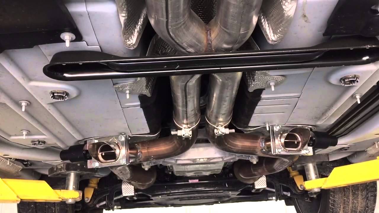

Trans tunnel cross brace is where you want to install the h-pipe. Black cross bar in this pic.
Attachment 1042663
It is in the middle of oe resonator. I will put H pipe connection there
That's the best spot for it. Like stated, if you look at all the aftermarket cat backs, that is where the X is, and also where the H should be as well. Good luck, hope you find the sound you want with the stock cans... Has your AFM/DOD been deleted in a tune? If not it is going to sound pretty crappy to you with a louder sound when it activates.
I don't need any gains. I just want old muscle sound and scavenging for not lose lower torque
The h pipe is perfect. I find the X pipe cleans up the sound better tho.
