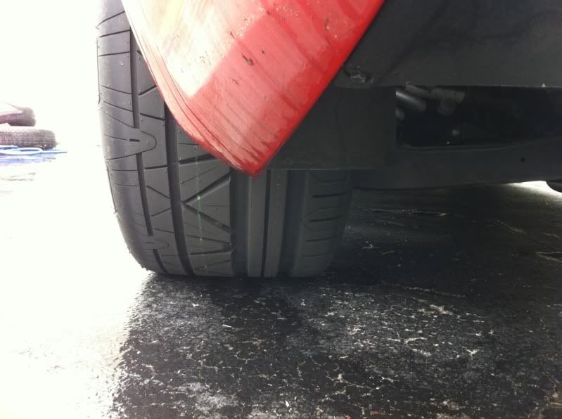

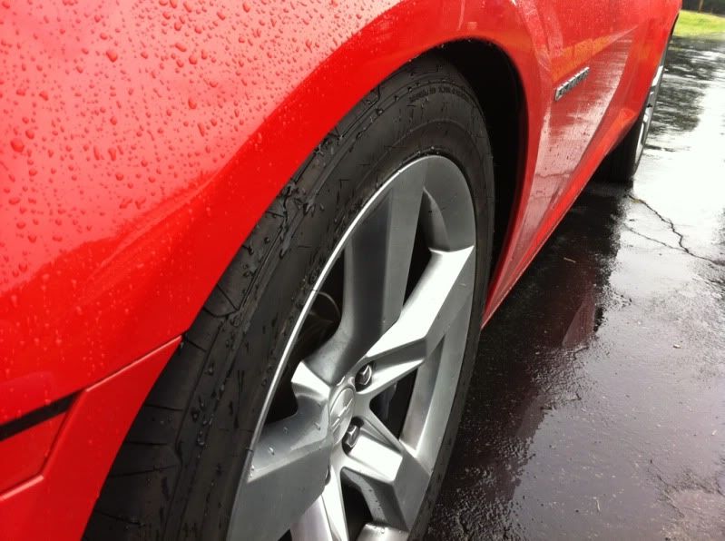

Is there a way I can run 20/10inch fronts and 20/11inch rears? What size spacers would I need? Same offset as stock. Was gonna put the 275s on the front 10inch wide wheel. Just kicking the idea around since I found a good deal on aftermarket wheels. Thoughts...
2SS\RS is offline   Reply With Quote
Old 09-04-2011, 03:12 PM   #243
yotaman96
yotaman96's Avatar
Drives: 2017 Camaro SS1LE 2000 Trans Am WS6
Location: Portland, TN
Posts: 2,952

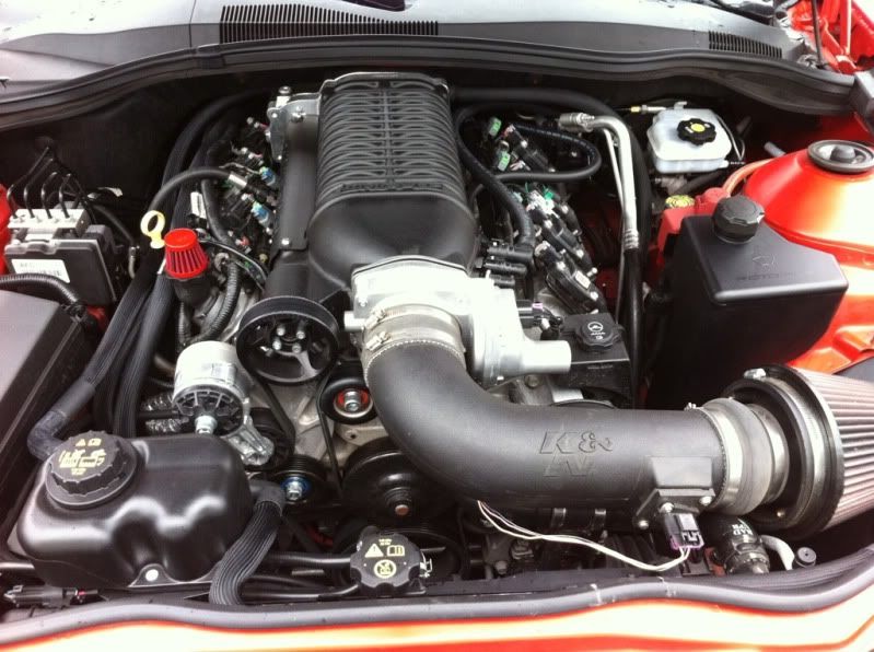

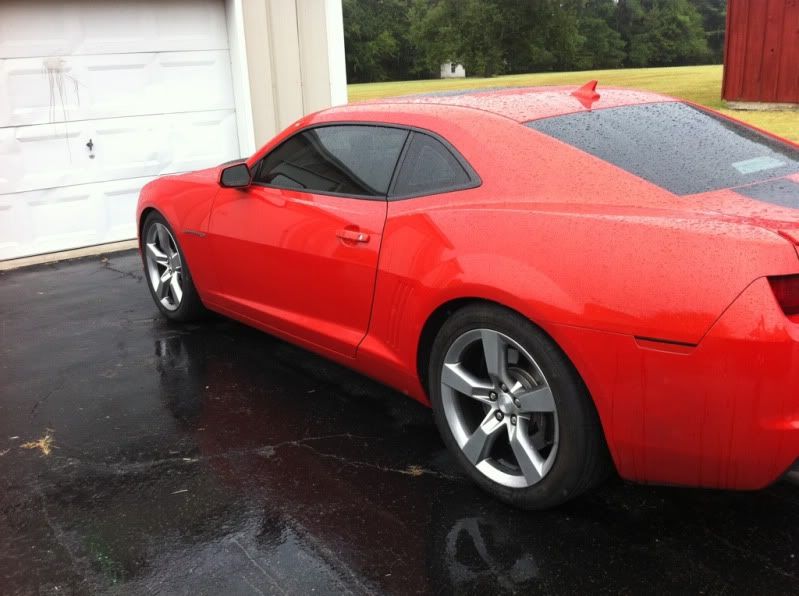

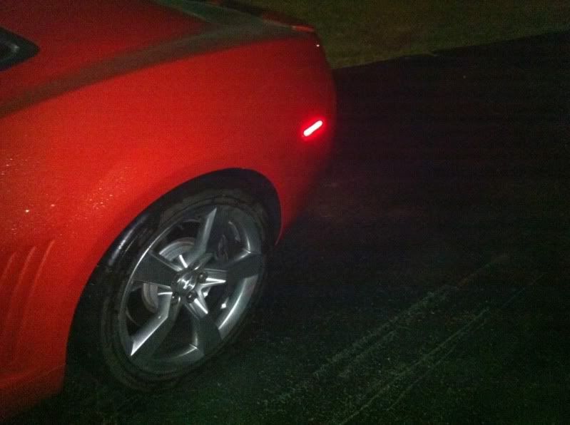

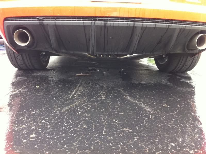

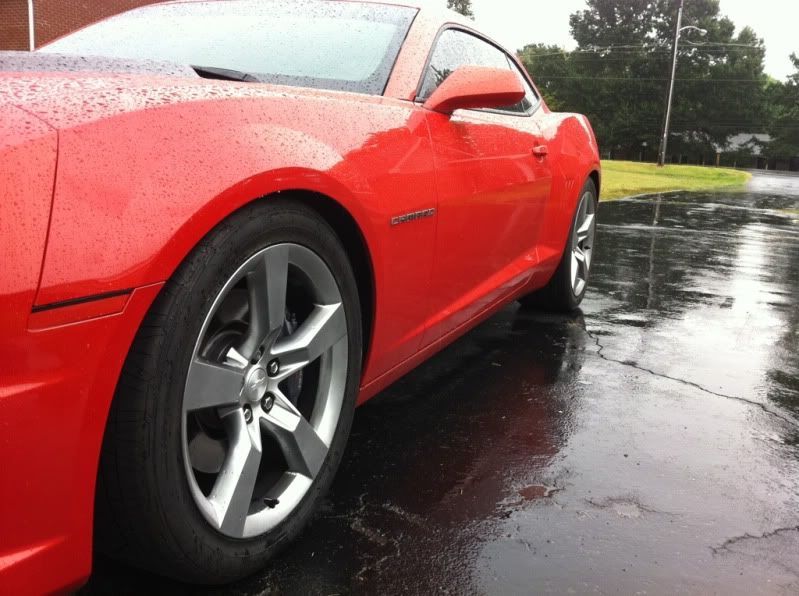

Alright, here are some pics of the stock 9" rears moved to the front and another pair of rears widened to 10.5". Sorry the car is dirty. I really like the 9" up front. I think the rears would look better moved out 15mm.
And a shot of the Whipple just for the heck of it. Been waiting a month for my CAI, so the filter on there now is temporary.
Glad you finally got your tires. I see the pics have been up for a week (I've been out of touch fighting fires lately).
The rear stockers look great up front. I think you're right about moving the rears out a little. I went 20mm just so I wouldn't have to cut the threads on the studs, but 15mm would probably look better.
How do you like that Whipple so far?

The Whipple is good. Still needs more power though. Had to stop racing at the LS Fest due to a leak at the oil cooler. The drag radials were too new to hook very well.
