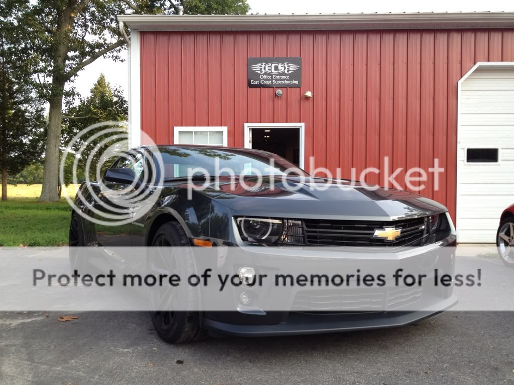

So is ECS just a barn behind someone's house?
With their presence in the industry I envisioned a much larger facility....with engine and chassis dynos, 20 lifts, CNC machines, etc.
But I guess you don't have to be large to be good.
Thats impressive.
speedmon is offline   Reply With Quote
Thats impressive.
That about sums it up.
Thats impressive.
The install center is on 5 acres with a house on the property thats rented with a separate dyno room, the machine shop is about the same size (with the CNC's-Bridgeports-welding equip-tubing benders etc etc etc) and is located down the road a 1/4 mile, then we have another building thats also the same size as the install center for housing the charger kits and product.
We have found it easier to separate these things and run them almost as separate companies.
It works for us, thanks!!
