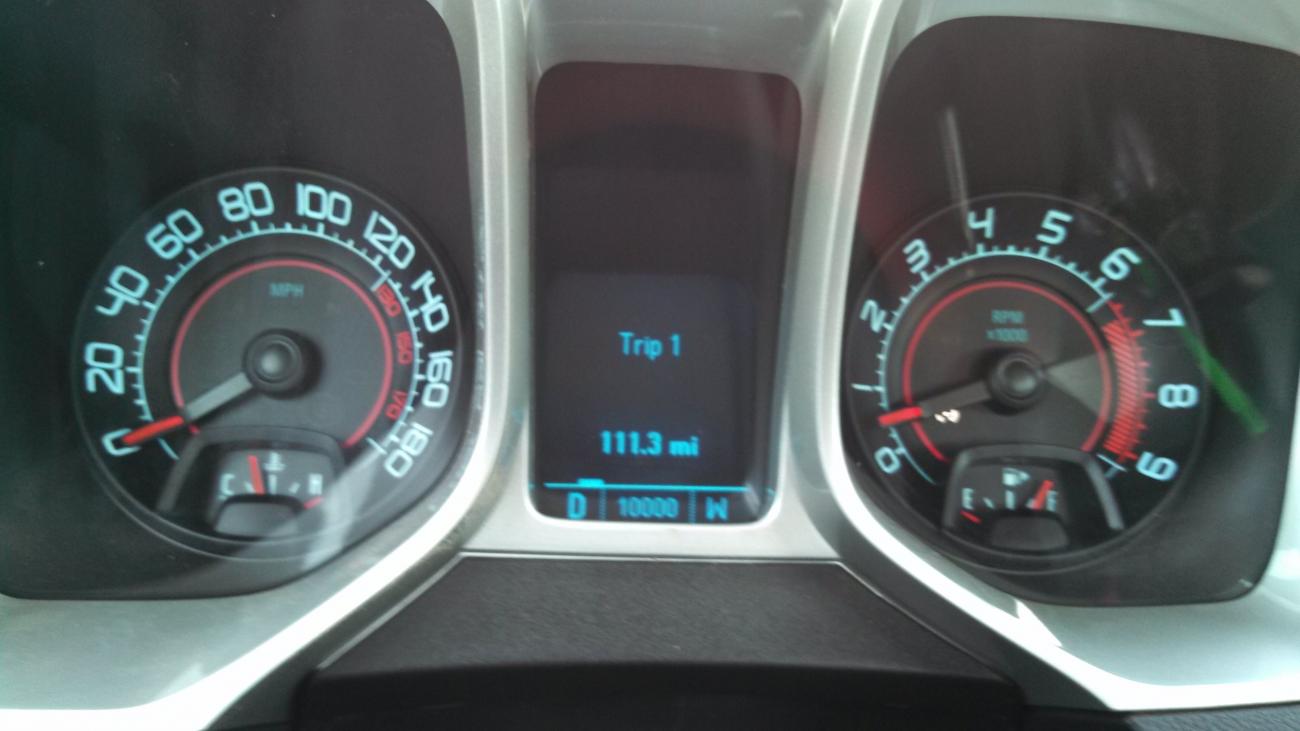

Time to sell
I was up in Denver last week sitting on I-25 ion traffic and looked down to see this...............
Wife says how did you get that many miles you never drive it?
2011 Synenergy Green 2SS/RS Automatic.
