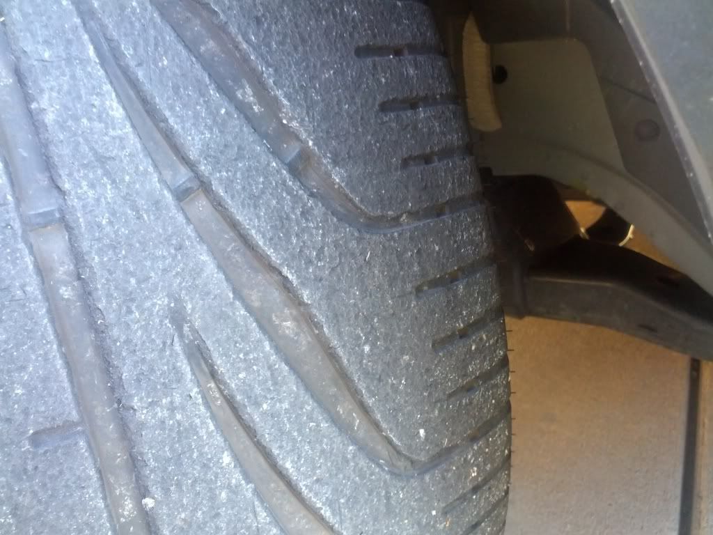

I haven't ran the super sports yet. I have ordered them for next season though. I ran the F1s this year and while I think they aren't a bad tire I am sure that there is something better to use. I found that after 4 or 5 runs they fall off rather quickly. In nearly every event I ran my fastest runs were on the third run. The tread gets really chewed up and the grip falls off. If I go run the tires on the street for 20 or 30 miles the tread will clean up and the grip will pick back up again. These pics were after my last event. I have roughly 2000 miles and four events on these tires.
